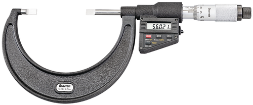

The Starrett 786 Electronic Blade-Type Micrometer with Non-Rotating Spindle With Output is a full-featured precision measuring tool built with customary Starrett quality and workmanship. The 786 series includes a large, easy-to-read, high-contrast LCD digital readout for clear readings and a speeder for quicker adjustment on all sizes. The non-rotating spindle prevents blade from turning in narrow slots or rolling off shoulder. Its no-glare satin chrome finish minimizes annoying surface glare under bright lights indoors or filters out UV light. This product features output capability for data transmission. Starrett electronic micrometers guarantee a precise measurement at every position each and every time. 0-25mm Range, 0.001mm Resolution time.

- Balanced frame and thimble design ensure easy handling and better readability
- Output capability for data transmission
- Conventional inch or millimeter graduations standard
- Quick and easy adjustment
- No-glare black wrinkle finish on frame
- Feature 09:
- Hard and stable one-piece friction thimble permits one-hand operation of micrometer and uniform contact pressure
- Feature 10:
- Rigid steel frame ribbed for strength and stability
- Feature 11:
- Ability to zero tool at any position as well as retain and return to the true zero reading of the micrometer
- Feature 12:
- One 3-volt battery included for extended usage
- Feature 13:
- Measurement HOLD button
- Feature 14:
- Automatic OFF
- Feature 15:
- RS232 data output port
- Feature 16:
- Feature 17:
- PRESET button to install any reading at any position
- Feature 18:
- Ability to install minimum and maximum limits
- Feature 19:
- Speeder for quicker adjustment on all sizes
- Feature 20:
- ME model turns on in millimeter mode after battery installation
