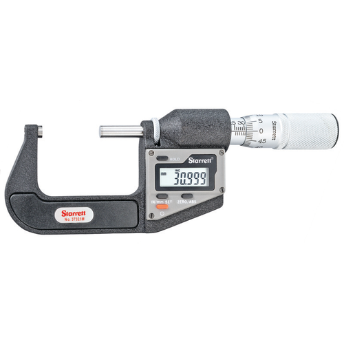

ELECTRONIC OUTSIDE MICROMETER, IP67 25-50mm (WITH OUTPUT)
795.1MXRL-50 DISCONTINUED PER ECO# 18218 7-14-20{LineFeed}REPLACED BY: 733.1MEXFLZ-50

Balanced frame design for comfortable and accurate measuring
SPC Output
Large, easy-to-read, high-contrast LCD digital readout
Starrett No-glare satin chrome finish on thimble and sleeve minimizes annoying surface glare under bright lights indoors or filters out UV light
No-glare black wrinkle finish on frame
Hard and stable one-piece thimble with rachet lock permits one-hand operation of micrometer and uniform contact pressure
Inch/millimeter metric conversion provides simple, universal, standardized unit of measurement at any position
Ring-type knurled lock nut for quick and sure locking

The Starrett 795.1 Electronic Micrometers provide an IP67 level of protection against coolant, water, chips, dirt, dust, and other contaminants in hostile shop environments. The 795.1 includes an RS235 output port for data transmission and works well with Starrett DataSure Wireless Data Collection Systems. The 795.1 full-featured electronic micrometers are built with customary Starrett quality and workmanship. 25-50mm Range,With Ratchet Stop, With Carbide Faces, With RS232 Output Port.
The direct replacement is 733.1MEXFLZ-50.
