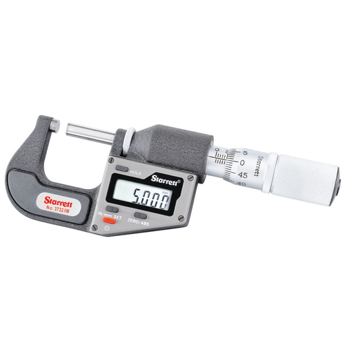

IP67 protection against coolants, water, chips, dust and dirt often found in machine shop environments
Balanced frame for comfortable and accurate measuring
Large, easy-to-read, high-contrast LCD digital readout
Starrett No-glare satin chrome finish on thimble and sleeve minimizes annoying surface glare under bright lights indoors or filters out UV light
No-glare black wrinkle finish on frame
Hard and stable one-piece thimble with rachet lock permits one-hand operation of micrometer and uniform contact pressure
Inch/millimeter metric conversion provides simple, universal, standardized unit of measurement at any position
Ring-type knurled lock nut for quick and sure locking
Feature 09:
Micro-lapped carbide measuring faces

796, 796M IP67 Electronic Digital Micrometer (without Output)
IP67 Outside Micrometer, Ratchet, Carbide Anvil, 0.001mm Res., 0-25mm Range

The Starrett 796.1 Electronic Micrometers provide an IP67 level of protection against coolant, water, chips, dirt, dust, and other contaminants in hostile shop environments. The 796.1 Electronic micrometers are built with customary Starrett quality and workmanship. 0-25mm Range, With Ratchet Stop, With Carbide Faces, Without Output.
The direct replacement is 733.1MEXFL-25.
