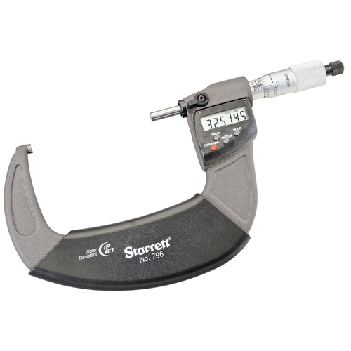

The Starrett 796 Electronic Micrometers provide an IP67 level of protection against coolant, water, chips, dirt, dust, and other contaminants in hostile shop environments. The 796 Electronic micrometers are built with customary Starrett quality and workmanship. 2-3" (50-75mm) Range, With Ratchet Stop, With Carbide Faces, Without Output.

- IP67 protection against coolants, water, chips, dust and dirt often found in machine shop environments
- Balanced frame design for comfortable and accurate measuring
- Hard and stable one-piece friction thimble permits one-hand operation of micrometer and uniform contact pressure
- Spindle lock
- Ability to zero tool at any position as well as retain and return to the true zero reading of the micrometer
