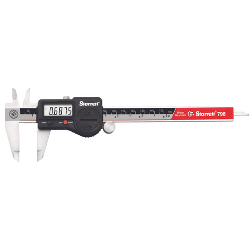

The 798BX Starrett Electronic Caliper with Carbide Jaws features a large, easy-to-read, high contrast LCD readout. It includes IP67 protection against coolants, water, chips, dust and dirt often found in machine shop environments. Its induction type linear encoder system and inch/millimeter metric conversion makes Starrett precision measuring tools the right choice for any job. This model features 0-6" measuring range and .0005" resolution. 0-6" (0-150mm), with Output, with Carbide, in Fitted Plastic Case.

- IP67 level of protection against coolant, water, dirt and dust
- Fine adjustment
- Hardened stainless steel measuring surfaces
- Induction type linear encoder system
- RS232 output
- Heavy-duty bar and slide
- Slide lock
- Feature 09:
- One 3-volt battery for over one year of normal usage
- Feature 10:
- In/mm conversion
- Feature 11:
- Zero at any position
- Feature 12:
- Auto-Off after 30 minutes
- Feature 13:
- Reactivation of display with no loss of position
- Feature 14:
- Works well with Starrett DataSure Wireless Data Collection Systems
