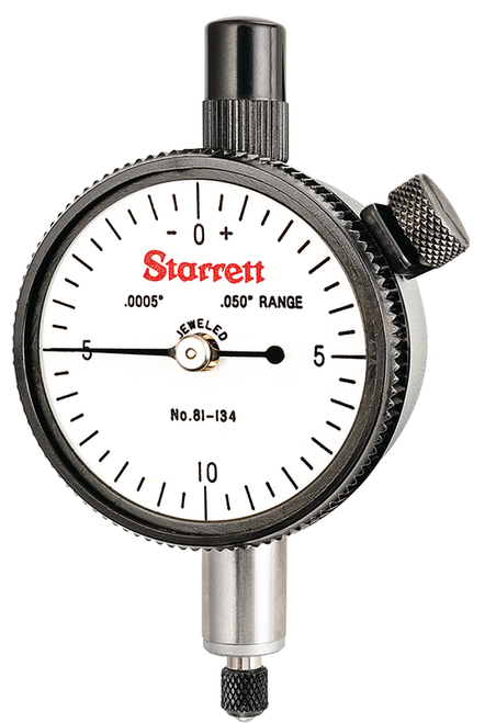

- MINI DIAL INDICATOR, 0 -.050", .0005" GRAD

- Built for gaging dimensions in tight places
- Equipped with high precision, low friction movements and frictionally adjustable bezels for quick, positive zero setting
- No-glare, white eggshell finish dials
- Black bezel, silver finish on case
- Furnished with balanced dial, jeweled bearings and lug-on center back
- Unbreakable crystal
- Hardened stainless steel bottom stems can be held in fixtures without cramping rack action

- The case is light but sturdy, with a hardened, precision stainless steel rack that rides in bronze bushings

- Direct acting compression spring eliminates side friction

- Contact points and backs can be ordered individually. Order by part number/EDP number

- Frictionally adjustable bezels for quick, positive zero setting

- Easy readability with the best, balanced style of graduation and number combination

- Balanced and tapered hands are easy to follow

- Furnished with balanced dial, jeweled bearings and lug-on-center back.
- Graduations (in):
- .0005"

- Range One Rev. (in):
- .020"
- Mini Dial Indicator, 0-.050" Range, 0-10-0 Balanced Dial, .0005" Grads, .020" Range Per Rev, .2185" Stem

- Stem Diameter (in):
- .2185"
- Total Range (in):
- .050"
