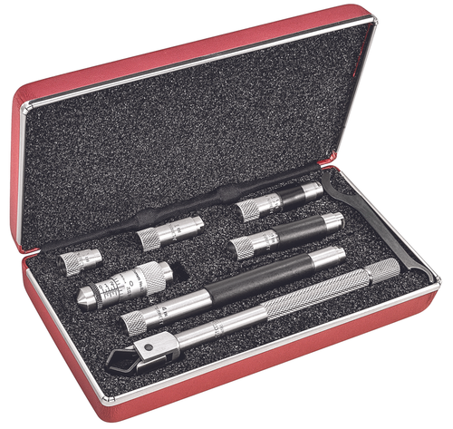

The Starrett 823 Tubular Inside Micrometer Set features .001" graduation, with 8 rods and handle, 1-1/2-12" range, and 1/2" movement of screw. 1 1/2-12" Range with 8 Rods/Handle, with Case screw.

- Rods are rigid and lightweight
- 5-1/2" (140mm) long handle furnished
- Each rod is marked with length
- Hardened and ground anvils
- Interchangeable anvils
- Quick reading figures
- Extension rods are made of steel tubing

- Measuring Rods (qty):
- 8 Rods and Handle

- Accuracy (in):
- Mic head +/- .0001"; Rods +/- .0002"
