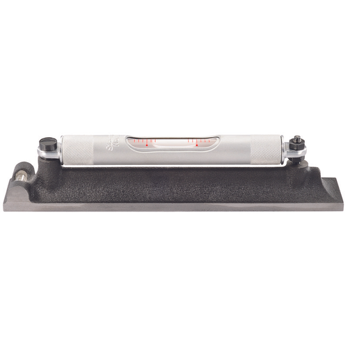

The Starrett 98 Machinists Level with Ground and Graduated Vial includes a cross test vial. 300mm (12") size, with wood case.
98Z-12 Machinists Level with Ground and Graduated Vial in Wood Case

- Description
- With single plumb vial, cross test vial and case

- Mechanical
- Ground and graduated main vials
- The base of the levels features an involute groove running the length of the base, which provides a reliable seat for round work
- Cross test vial
- The vials are adjustable to a positive setting and are housed in a satin finished brass tube with a friction-fit closing cover to prevent breakage
- Main level vials have graduations that are approximately 80-90 seconds or .005" per foot (0.42mm per meter)
