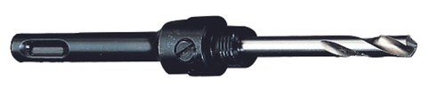

HOLE SAW ARBOR, With Pilot Drill, Fits Hole Saw Diameter 9/16" - 1-3/16" (14 - 30mm), Shank Size 11/32" (8.75mm) Hex, Quick Hitch

Fits Hole Saw Diameter (in)
8466.10.0175
339
China
9/16" to 1-3/16"
Fits Hole Saw Diameter (mm)
14mm to 30mm
Fits Chuck Size (in)
3/8"
Fits Chuck Size (mm)
9.5mm
Shank Size (in)
11/32"
Shank Size (mm)
8.75mm
Screw Thread
1/2-20
Drill (HSS)
Drill (Carbide Tipped)
Drill Length (in)
3-5/8"
Drill Length (mm)
92mm

Fits hole saws from 14-30mm (9/16-1.3/16") diameter
Arbor suitable for use with MPH Hole Saws
Supplied with a longer pilot drill to allow for the deeper cutting depth of the MPH hole saw

Hole Saw arbor supplied with extended length 6.35mm (1/4") pilot drill. Shank size 8.75mm (11/32"). Screw thread 1/2"-20.
