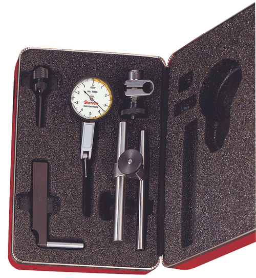

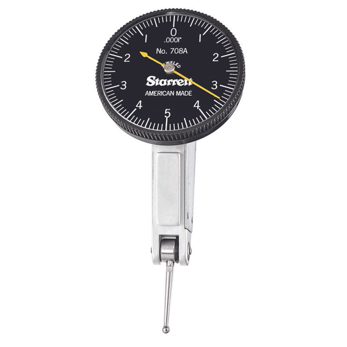

The Starrett 708 Dial Test Indicator with Dovetail Mount offers an easy to read angled head and the flexibility of three dovetail mounts.

- Mechanical
- Angled head for better reading position
- Three dovetail positioning moutns work with existing test indicator accessories
- Large 1-3/8" (35mm) dial diameter
- Precision gear-driven design with smooth, jeweled movement
- Narrow body for inreach ability
- Contact point reverses automatically, always maintaining clockwise hand rotation
- Red dial color, .0001" graduation, .010" range, 0-5-0 dial reading with 13/16" (20mm) carbide contact point and .078" (2mm) ball diameter
