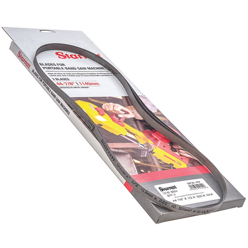

Univerz Porta-Band blades utilize Starrett's Patented "Twin Tooth" design bi-metal unique® saw technology for faster cutting and longer blade life.
44-7/8" - 3' 8-7/8" (114cm) in Length, 1/2" Wide x .020" Thick (13 x 0.50mm) with a 18 pitch and wavy set, zero rake
Triple tempered M-42 cobalt high speed steel teeth with a fatigue resistant alloy steel backer
Available in a variety of tooth pitches
Portable Band Saw

3 Ft. 8-7/8 In. Univerz™ Portaband - 1/2" Width, .020" Thickness, 18 TPI. The Univerz portable band saw blade utilizes Starrett's exclusive bi-metal unique saw technology for faster cutting and longer blade life. Designed for use on on portable machines. PLEASE NOTE: Bulk packs contain 100 blades. Must order in multiples of 100. Prices are for Each blade.
  • Power Tool: Portable Band Saw
  • Industries Where Used: Fabricators, Maintenance and Repair (MRO), Construction Sites
    • Highly Recommended: Carbon Steel , Copper Alloys, Metal
    • Recommended: Aluminum, Carbon Steel Alloys, Composites, High-Speed Steel, Plastic, Stainless Steel
    • Suitable: Cast Iron, Wood
    • Small workpieces up to 2 inches (50mm) in cross section
    • Angle iron
    • Bolts
    • Conduit
    • Pipe
    • Rebar
    • Screws
    • Threaded rod
    • Tubing
