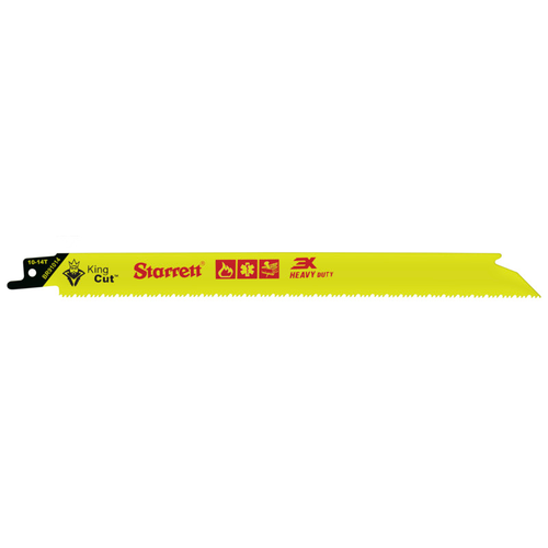

King Cut is a thicker blade than our standard bi metal reciprocating blades
Purpose designed for heavy-duty demolition and emergency extrication
The blade for ripping through just about anything
Straight blade format
