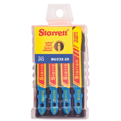

BU232-20 Metal Cutting Jig Saw Blades

Metal Cutting, Unified Shank, Bi-Metal Unique, Jig Saw Blades, 2" x 5/16 x .040 x 32 Tpi, 20 Pack

2'' x 5/16 x .040 x 32 TPI, Metal-Cutting Bi-Metal Jig Saw Blade, 20 Pack
  • 2" (50mm) Length
  • 5/16"(7.5mm) Blade Width
  • .040"(1.0mm) Thickness
  • 32 Teeth per Inch (TPI) Pitch
  • Wavy Tooth Set
  • Regular Tooth Style
  • 20 blades in package.
  • Application(s): Cutting, Straight Cuts, Curved Cuts
  • Power Tool: Jig Saw
  • Industries Where Used: Aerospace, Agriculture, Automotive, DIY, Defense, Energy, Fabricators, HVAC, Machine Shops, Maintenance and Repair (MRO), Marine, Metalworking, Performance Automotive, Utilities, Mechanical workshops, Toolroom
    • Highly Recommended: Metal, Steel
    • Recommended: Aluminum, Copper Alloys
    • ACM Panels (Aluminum Composite Material)
    • Sheet metal
    • Tubing
