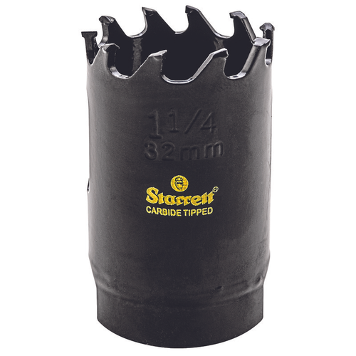

HIGH PERFORMANCE TRIPLE CHIP TUNGSTEN CARBIDE TIPPED HOLE SAW, 1" - 25mm DIAMETER

A cost effective solution for cutting nail embedded wood, or wood and metal combination, reinforced concrete and fibreglass
Leaves high quality surface finish on entry and exit and provides a smooth cut when cutting traditional lathe and plaster
Tungsten Carbide Tipped teeth for outstanding cutting performance and product durability
Will cut nail embedded wood or virtually and wood and metal combination
Cutting Depth of 41mm (1.5/8" )
Suitable for use in mains and battery operated tools

High performance triple chip tungsten carbide tipped hole saws. Ultra-high hardness provides long life when cutting difficult and abrasive materials including wood, PVC and fiberglass. 41mm (1-5/8") cutting depth.
