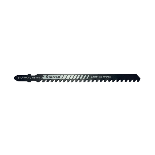

Unified shank to fit a variety of machines
5" x .3" x .05" x 6 TPI
4" tooth bearing length
Equivalent to T341HM
Up to 31/8" cutting capacity
Straight cuts with an upward stroke

5" x .300" x .050" Carbide Tipped Jigsaw Blade, 6 TPI, 2-Pack

5" Carbide Tipped Jig Saw Blades, .300" Width, .050" Thickness, 6 TPI, Pack of 2 Blades.
Designed for quick and precise cuts on tough and abrasive materials, this blade ensures an extended lifespan compared to standard options. Plus, enjoy smooth and efficient cutting  that not only reduces trigger time but also minimizes operator exposure to harmful vibrations.
  • Power Tool: Jig Saw
  • Industries Where Used: Aerospace, Agriculture, Automotive, DIY, Defense, Energy, Fabricators, HVAC, Machine Shops, Maintenance and Repair (MRO), Metalworking, Construction Sites, Mechanical workshops, Carpentry Shops
    • Highly Recommended: Aluminum, Building Materials, Composites, Fiberglass, Gypsum, Laminates
    • Cement board
    • Drywall
    • Hard wood
    • MDF
    • Plaster board
    • Graphite
    • Carbon fiber
