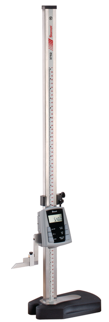

- Clear bar graduations in .100" and 5mm increments
- Large (9.65mm/3/8"), easy-to-read LCD display reads to 0.01mm or .0005"
- Instant inch-millimeter conversion
- Carrier and scriber designed to read from zero
- Hold control feature retains a reading at any position
- Plus or minus indication allows reading in proper direction
- Ability to set zero at any position
- Manual on/off plus a built-in automatic off after 30 minutes of nonuse
- Feature 09:
- Large positive action keypad
- Feature 10:
- Ability to retain and return to the true zero reading of the height gage
- Feature 11:
- PRESET button to install any reading at any position
- Feature 12:
- Ability to install minimum and maximum limits
- Feature 13:
- RS232 data output port
- Feature 14:
- Works well with Starrett DatasureWireless Data Collection Systems
- Feature 15:
- 1-1/2+ years battery life. Two 3-volt batteries furnished (CR2450).
