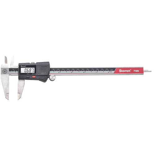

The Starrett EC799 Series Electronic Caliper is light, comfortable, easy-to-use, and constructed with features that have made Starrett slide calipers the machinist's first choice for many years. The EC799 offers a slim, streamlined profile, a large, clear, easy-to-read LCD display, long battery life, and function buttons for zero and inch/mm. Electronic Caliper, 0-8" (0-200mm), w/Output, w/Plastic Case with Standard Letter of Certification

- Resolution (in):
- .0005"
- Resolution (mm):
- 0.01mm

- Accuracy (in)
- 0-4”: (+/- .001”) >4” - 8”: (+/- .0015”)
- Accuracy (mm)
- 0 -100mm: (+/- 0.02mm) >100mm - 200mm: (+/- 0.04mm)
- Output
- Cabled Only
- SLC Certification
- Included
- Inside Jaw Depth (in)
- 3/4"
- Inside Jaw Depth (mm)
- 19mm

- Lightweight, ergonomic design
- Last measuring position retained when shut off
- Inch/millimeter conversion reads .0005" or 0.01mm
- Zero at any position
- Fine adjustment thumb wheel
- Hardened stainless steel body
- Auto-Off after 30 minutes
- Feature 09:
- Integrated depth rod
- Feature 10:
- RS232 output
- Feature 11:
- Output jack
- Feature 12:
- Works well with Starrett DataSure Wireless Data Collection Systems
