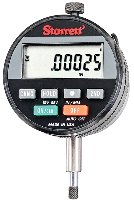

The Wisdom 2700 Electronic Indicator is our most versatile electronic indicator. All indicators feature a glass scale design with an unsurpassed accuracy of ± two resolutions when measuring from a known standard. All have rugged, sealed enclosures as well. American designed and manufactured. 15mm Range.

- Rugged, sealed enclosures
- Our most versatile line of electronic indicators
- Available in three styles
- Remote display and accompanying probe series
- Glass scale design with an unsurpassed accuracy of two resolutions when measuring from a known standard
- American designed and manufactured
- All available resolutions can be utilized in the same indicator, provided they are coarser than the resolution of the purchased model
- 10 resolutions and 5 measuring ranges available
- Feature 09:
- Starrett can customize WISDOM models to meet your needs
- Feature 10:
- Units can be designed with features such as: Special measuring ratios like 2:1 and 4:38
- Feature 11:
- Rotating bezel
- Feature 12:
- Output data can be used by a variety of peripherals for analysis, data collection and hard copy documentation
- Feature 13:
- Output jack allows data transmission
- Feature 14:
- Zero the tool at any position of the spindle
- Feature 15:
- Hold button to freeze display: Displays and holds the reading after the measurement has been taken
- Feature 16:
- Preset mode to install any reading at any point in the display. Reading is retained even if the indicator is turned off
- Feature 17:
- Plus or minus travel direction
- Feature 18:
- Auto Off: After 10 minutes of nonuse. When Auto Off is engaged, an hourglass figure appears at the left side of the display
- Feature 19:
- T.I.R.: Displays the difference between the highest and lowest values reached
- Feature 20:
- Maximum Reading Hold
