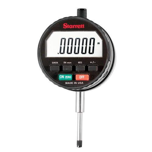

The 2700 Wisdom Indicator is one of the most versatile electronic indicators available. Features include an innovative true absolute sensor technology with an unsurpassed accuracy, and rugged, sealed enclosures. Cat No. F2730ADM features 25mm Range, 0.02/0.01/0.002/0.001mm Resolution, M2.5 x 0.45 Thread, 8mm Stem diameter, with SPC Output.

- Absolute Sensor-never lose positioning
- Longer Battery Life-6K hours of daily use
- No Over-Speed Error
- Cable Connection Icon
- Low Battery Warning
- Easy Exit Programming
- 1/2" Tall characters

- Tolerance Green/red LEDs

- Extended Analog Length from 30 to 40 Grads
- Feature 11:
- Data Send Button

- Range (in):
- 1"
- Range (mm):
- 25mm
- Resolution (in):
- .001"|.0005"|.0001"|.00005"
- Resolution (mm):
- 0.02mm|0.01mm|0.002mm|0.001mm
- 2700AD Electronic Digital Indicators
- Analog Display Digital Indicator, SPC Output, 1"/25mm Range, .001/.0005/.0001/.00005"- 0.02/0.01/0.002/0.001mm Res., 8mm Stem Diameter
- Stem Diameter (mm):
- 8mm

- Accuracy (in):
- +/- .0001"
- Accuracy (mm):
- +/- 0.002mm
