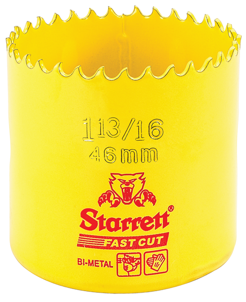

Provides a smooth cut, with minimal tendency to bite or snag on contact with irregular surfaces.
Constructed of hardened steel and abrasion resisting High Speed Steel Teeth with a tough alloy body and cap
5-1/2 teeth per inch/25mm make this saw ideal for thinner gauge material.
Cutting depth of 41mm (1-5/8" )

1-13/16'' (46mm) Fast Cut Straight Pitch Bi-Metal Hole Saw
Hardened, heat resistant HSS, with alloy backing and a straight 5.5-pitch smoothly cuts thin cross sections of sheet metal, corrugated or perforated steel, and applications with interrupted cuts. 1-5/8" cutting depth.
  • Industries Where Used: Automotive, DIY, Fabricators, HVAC, Maintenance and Repair (MRO), Metalworking, Construction Sites
    • Highly Recommended: Aluminum, Copper Alloys, Metal, Non-Ferrous Metals, Stainless Steel, Titanium Alloys
    • Recommended: Gypsum
    • Suitable: Acrylic, Cast Iron, Fiberglass, Plastic, Wood
    • Sheet metal up to 1/8” (3mm) Thick
    • Tubing with Wall Thickness up to 1/8” (3mm) Thick
    • Drywall
    • Plaster board
