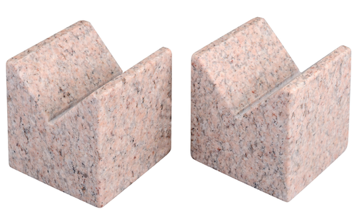

Granite Five-Face V-Blocks, sold as matched pairs, hold and support cylindrical pieces during inspection or manufacturing. They have five finished faces. They have a nominal 90-degree "V", centered with and parallel to the bottom and two sides and square to the ends. They are available in five sizes and are made from our pink granite.

- Ideal for supporting or holding cylindrical pieces during manufacturing or inspection.
- Provided in matched pairs.
- V-Blocks have a 90-deg "V" centered with an parallel to the bottom and two sides and square to the ends (5 finished faces).
