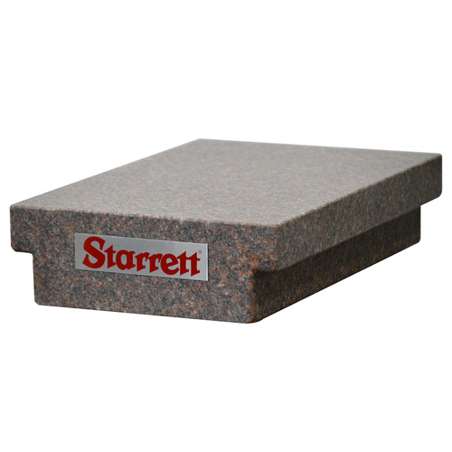

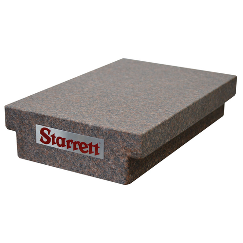

G-85058 24" x 36" x 6" Surface Plate
24" x 36" x 6" Superior Black Granite Surface Plate - Grade A, No Ledge
Size LxWxT (in):
24 X 36 X 6
Size LxWxT (mm):
600 X 900 X 150
8
38
610
430
SDS Indicator:
24" x 36" (600mm x 900mm) Superior Black Granite Surface Plate with a 6" (150mm) thickness. Superior Black Granite has low water absorption, creates little glare and minimized thermal expansion Grade A (Inspection Grade) for general work in quality control. .000200" (0.0051mm) Flatness unilateral tolerance. Produced without ledges.
The direct replacement is G-80658.
[Discontinued 05/2022]
