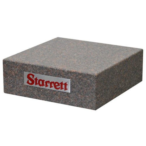

12" x 12" (300mm x 300mm) Superior Red Granite Surface Plate with a 4" (100mm) thickness. Superior Red Granite offers unparalleled wear resistance compared to other surface plates. Grade B (Toolroom Grade) for production checking work throughout the shop. .000200" (0.0050mm) Flatness unilateral tolerance. Produced without ledges.

- Meets or exceeds U.S. Federal Specification GGG-P-463c and ASME B89.3.7 2013 for flatness.
- Best surface hardness and wear resistance - The highest percentage of quartz crystals of any granite plate.
- Smooth, jewel-like quartz bearing points protect accuracy and finish of both the surface and the tools used on it.
- Quality and economy combined.
- Comparable to black granite plates while outwearing them as much as 5 to 1.
- Meets or exceeds 50 lb per square foot (24kg per 1,000 sq. cm) load bearing specifications. Available in 100 lb (45kg) test series.
- Standard-size plates are mounted on resilient support pads, providing isolation from normal vibration and a non-distorting 3-point suspension.
- Packed one per crate with skids for forklift handling.
