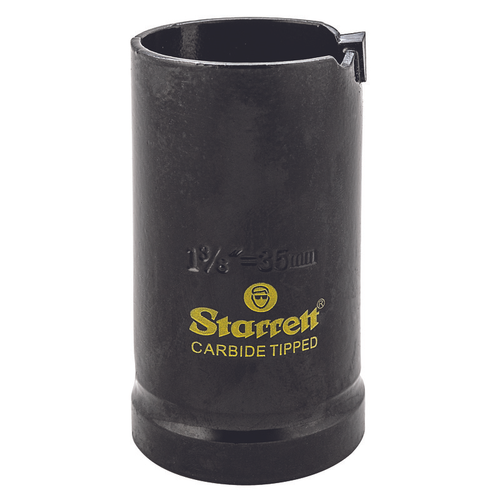

Power through wood, MDF, plastics, plasterboard and ceramic wall tiles up to five times faster than a bi-metal hole saw
Carbide Tipped teeth for outstanding cutting performance and product durability. Cutting depth of 54mm (2.1/8" )
Smooth cut with minimal heat build up
Suitable for use in mains and battery powered tools
Multiple uses - cut wood, MDF, plastics, ceramic wall tiles and building bricks
Special arbors featuring extended length pilot drills are available

TCT TUNGSTEN CARBIDE TIPPED, 2-9/16" - 65mm DIAMETER

2-9/16'' (65mm) Carbide Tipped Multi-Purpose Hole Saw
TCT tungsten carbide tipped multi-purpose hole saws with a unique tooth set for an ultra-aggressive, high performance cutting of non-metallics. Rapid, heat-free stock removal of wood, MDF, plastics, and ceramic tiles. 54mm (2-1/8") cutting depth.
