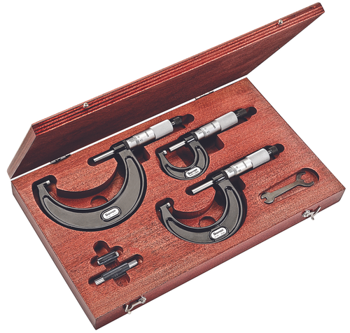

The Starrett ST436.1DXRLZ Outside Micrometer Set includes 7", 8", 9", 10", 11", and 12" micrometers, five standards, adjusting wrench, in case. The most popular precision micrometers used by skilled workmen worldwide. Anvils sized at .250" (6.35mm) diameter for ease of use on larger work. This model features 6-12" Measuring Range. Smooth friction thimble for uniform pressure, the combination ratchet and speeder for uniform pressure and quicker adjustment, or a plain micrometer that depends on your own feel. Recommended for mechanics, automotive service and machine shops, toolrooms, inspection departments and wherever gaging involves a wide range of measurements.
