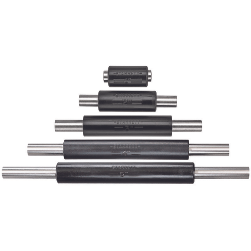

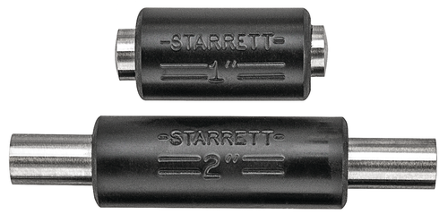

Electronic or Mechanical:
Mechanical
Used on machine tools for comparing gages
Ideal for checking precision measuring tools
Useful for measuring parallel surfaces
These standards are the ones used for all micrometers furnished with standards
Made of special tool steel in rod form with ends hardened and accurately lapped to a spherical radius
Larger sizes available on special order

End Measuring Rod Set with Insulated Handle and Spherical Ends, 25mm-50mm, 2 Pieces
The S234MC Standards Set is designed for checking and setting Starrett S436.1M and S436M Micrometer sets with 0-75mm range. These End Measuring Rods or "Standards" are also used on machine tools for comparing gages, checking precision measuring tools, for measuring parallel surfaces, and many other types of work. They are made of special tool steel in rod form with ends hardened and accurately lapped to a spherical radius. Rods or Standards are for checking and setting micrometers of 50mm to 75mm capacity
