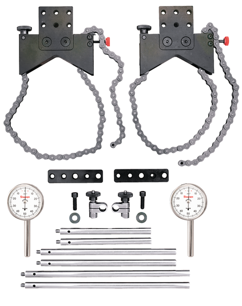

Lightweight clamp design made of black anodized aluminum
Rigid 3/8" diameter stainless steel indicator posts provided in three lengths (5", 7-7/16", and 9")
Extension plate allows for added radial clearance
Heavy-duty roller chain can accommodate up to a 7-1/2" diameter shaft
Sets are available with either two Starrett 196B5 or 81-141J Indicators
Excess roller chain can be secured to the side of the chain clamp
A second shaft alignment clamp can be mounted across from the first clamp to act as a vertical target for face alignment

Shaft Alignment Clamp Set, with 2 each: Chain Clamp, Extension Plate, Posts (5", 7-7/16", 9"), Fitted Case

2 each: Chain Clamps, Extension Plates, Posts (5", 7-7/16", 9"), Fitted Case
The Starrett Shaft Alignment Clamp is designed for fast, precise alignment of motors, pumps, compressors, etc. This system is capable of addressing radial and angular misalignment problems and can be set up within minutes.
