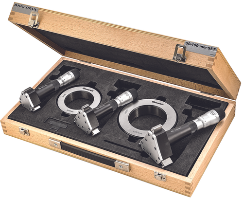

Wide measurement range without changing anvils
Tungsten carbide measuring faces on all 3-point heads above 1/2" (12.5mm)
Ratchet stop ensures consistent measurements
Self-centering contacts for true readings
Blind bore measuring capability above 1/2" (12.5mm) diameter
Extensions available up to 6" (150mm) for deep hole measuring
Setting rings included
Depth stop/collar also available for .080"-.250" (1-6mm) range

Each micrometer bore gage is furnished in a case, complete with setting ring, contacts, wrenches, and instructions

The Starrett 78XT Series Internal Micrometer features extended travel, reducing the need to exchange anvils. The ground contact point seats the internal micrometer faster and more accurately than the spherical contacts found in other gages. The rugged and accurate internal micrometer is available individually or in economical sets from .040-12" (1-300mm). SET, 2 - 4" Range, w/3 Point Carbide Contact.
