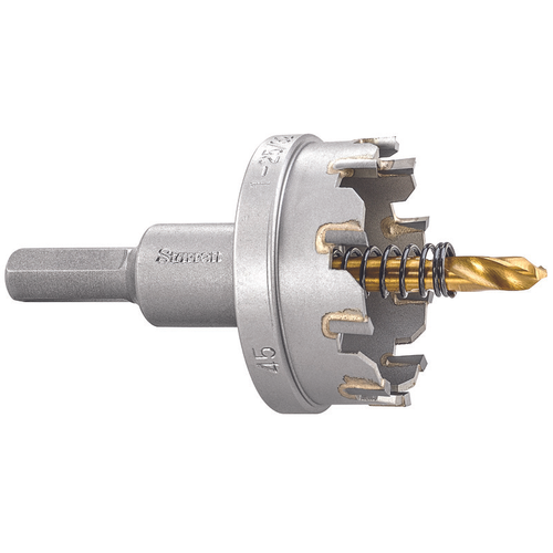

Ideal for cutting stainless and high alloy steels, non-ferrous light metals and reinforced fabrics at a much faster speed than bi-metal holesaws
Tough Tungsten Carbide Tipped teeth have a positive cutting angle which provide fast and efficient removal of chips and swarf
Ideal for production cutting and particularly suitable for use in drills with limited speed control
Tungsten Carbide Tipped teeth provide superb product life and cutting performance
Safety stop at the base of the hole saw prevents drilling beyond the maximum cutting depth of 13mm (1/2" )
Complete assembly - there is no requirement to purchase a separate drive arbor and pilot drill (Replacement pilot drills available)
1'' (25mm) Carbide Tipped Sheet Metal Hole Saw
Tungsten carbide tipped with positive rake teeth for high alloy and stainless steels, nonferrous metals and reinforced fabrics. Complete assembly with arbor and pilot drills. Recommended for use on sheet metal up to 1/8" (3mm) thick.
