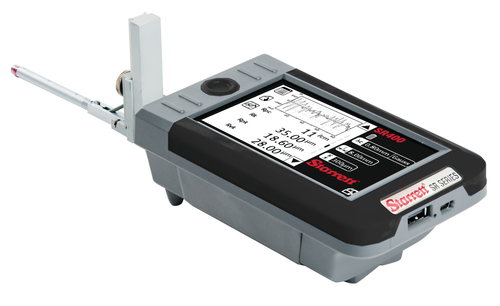

The Starrett SR300 Surface Roughness Tester is a full-featured, powerful and versatile surface roughness tester. It can be used either freestanding or bench mounted with fixturing for batch measurement and laboratory applications. Display & Traverse unit; Pick-up & Diamond Stylus; Calibration Std; Manual; and Case. 17.5mm travel, 200um range, 10nm resolution, Standard Parameter Set (ISO 4287, ASME, JIS)
