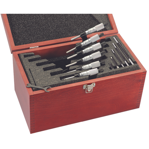

The most popular precision micrometers used by skilled workmen worldwide
Accurate, rugged, and easy to use
All sets come with attractive, protective case, which keep micrometers and standards together, readily accessible
Hard and stable one-piece friction thimble permits one-hand operation of micrometer and uniform contact pressure
Balanced frame and thimble design ensure easy handling
Gracefully designed tapered frame for use in narrow slots and tight places
Micro-lapped measuring faces
Starrett No-glare satin chrome finish on thimble and sleeve minimizes annoying surface glare under bright lights and resists rust

Outside Micrometer Set, Ratchet Thimble, Carbide Anvil-Spindle, 6-12" Range, .0001"
The Starrett S436 Outside Micrometer Set includes 7",8",9",10",11"and 12" micrometers, two standards, adjusting wrench, in case. The most popular precision micrometers used by skilled workmen worldwide. Anvils sized at .250" (6.35mm) diameter for ease of use on larger work. This model features 6-12" Measuring Range. Smooth friction thimble for uniform pressure, the combination ratchet and speeder for uniform pressure and quicker adjustment, or a plain micrometer that depends on your own feel. Recommended for mechanics, automotive service and machine shops, toolrooms, inspection departments and wherever gaging involves a wide range of measurements.
