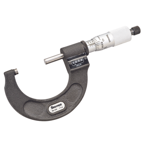

This is the Starrett mechanical digital micrometer - simple to use even by the inexperienced
Clear, easily read numbers reduce errors
Balanced frame design for comfortable and accurate measuring
Gracefully designed tapered frame for use in narrow slots and tight places
Carbide Measuring Faces
Micro-lapped measuring faces
Starrett no-glare satin chrome finish on thimble and sleeve
No-glare black finish on the frame
Feature 09:
Ring-type knurled lock nut for quick and sure locking
Feature 10:
The anvil and spindle are sized at .250" (6.35mm)
Feature 11:
Extremely hard and stable one-piece spindle
Feature 12:
Smooth friction thimble for uniform pressure
Feature 13:
.001" or .01mm is read directly from the counter
Feature 14:
.0001" or .001mm is read from the vernier scale on the micrometer sleeve

T216XFL-2 Digital Micrometer
Range (in):
1-2"
Mechanical Counter Outside Micrometer, Friction Thimble, Carbide Anvil-Spindle, 1-2" Range, .0001"

The Starrett 216 Digital Micrometer is a mechanical digital micrometer - simple to use even by the inexperienced. The anvil and spindle are sized at .250" (6.35mm). 2", .0001" Grad, Carbide Faces, Friction Thimble, Lock Nut. Note: This item is discontinued. Please consider the recommended alternative listed above or contact our special order department at (978) 249-3551 x410 for more information.
The direct replacement is T216XRL-2.
