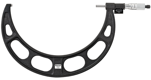

The Starrett 216 Digital Micrometer is a mechanical digital micrometer - simple to use even by the inexperienced. The anvil and spindle are sized at .250" (6.35mm). 1", .0001" Grad, Carbide Faces, Ratchet Stop, Lock Nut, SLC

- Includes ratchet stop and lock nut
- With standard letter of certification
- Carbide measuring faces
- 0 to 1" Range
- .0001" Graduation
- Feature 11:
- Feature 12:
- Combination ratchet and speeder for uniform pressure and quicker adjustment
- Feature 13:
- .001" or .01mm is read directly from the counter
- Feature 14:
- .0001" or .001mm is read from the vernier scale on the micrometer sleeve
