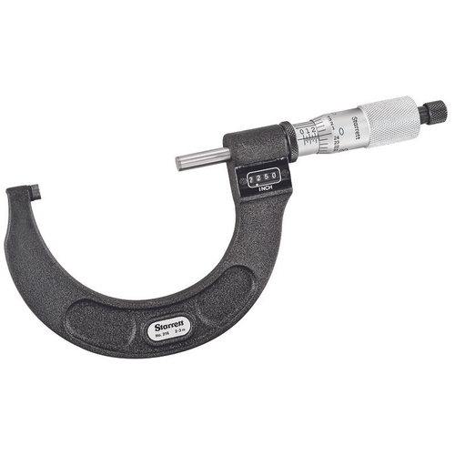

The Starrett 216 Digital Micrometer is a mechanical digital micrometer - simple to use even by the inexperienced. The anvil and spindle are sized at .250" (6.35mm). 5", .0001" Grad, Carbide Faces, Ratchet Stop, Lock Nut.

- This is the Starrett mechanical digital micrometer - simple to use even by the inexperienced
- Clear, easily read numbers reduce errors
- Balanced frame design for comfortable and accurate measuring
- Gracefully designed tapered frame for use in narrow slots and tight places
- Carbide Measuring Faces
- Micro-lapped measuring faces
- Starrett no-glare satin chrome finish on thimble and sleeve
- No-glare black finish on the frame

- The anvil and spindle are sized at .250" (6.35mm)

- .001" or .01mm is read directly from the counter
- Feature 13:
- .0001" or .001mm is read from the vernier scale on the micrometer sleeve
