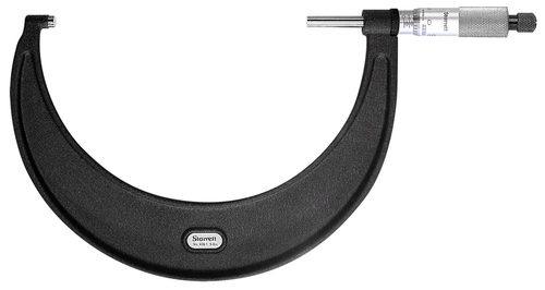

Starrett 436.1 Outside Mechanical Micrometers are the most popular precision micrometers used by skilled workmen worldwide. They are accurate, rugged, and easy to use. T436.1XRL-6 features a 5-6" range, .0001" graduations, and a flat, carbide anvil. The locknut is knurled ring type, with ratchet thimble. Produced with a black wrinkle frame finish. Furnished with a storage case. Standard Letter of Certification (SLC) is available as an optional add-on.

- Outside
- Range (in)
- 5-6"
- Graduations (in)
- .0001"
- Accuracy (in)
- +/- .0001"
- Anvil/Spindle Material
- Carbide
- Anvil Type
- Flat
- Spindle Type
- Flat
- Lock Nut Type
- Knurled Ring Type
- Thimble Type
- Ratchet
- Frame Finish
- Black Wrinkle
- SLC Certification
- Optional Add-On
- Case Type
- Plastic
- Accuracy (in):
- +/- .0001"
- Anvil Type:
- Flat
- 0049659680317
- 68031
- Mechanical
- The most popular precision micrometers used by skilled workmen worldwide
- Accurate, rugged, and easy to use
- Starrett satin chrome finish - no glare - resists rust
- Balanced frame and thimble design ensure easy handling
- Gracefully designed tapered frame for use in narrow slots and tight places
- Quick and easy adjustment
- Micro-lapped measuring faces
