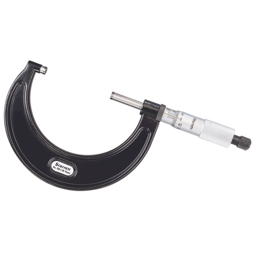

Starrett 436.1 Outside Mechanical Micrometers are the most popular precision micrometers used by skilled workmen worldwide. They are accurate, rugged, and easy to use. V436.1MXRL-150 features a 125-150mm range, 0.001mm graduations, with flat, micro-lapped carbide measuring faces. The locknut is knurled ring type with a ratchet thimble. Produced with a satin chrome finish on the sleeve and thimble for easy readability and a black wrinkle frame finish. Standard Letter of Certification (SLC) is available as an optional add-on. The 436.1 blends quality construction with smooth, repeatable performance—making it the go to mic for shop floors, inspection rooms, and manufacturing environments where accuracy cannot be compromised.

- Outside
- Range (mm)
- 125-150mm
- Graduations (mm)
- 0.001mm
- Accuracy (mm)
- +/- .004mm
- Anvil/Spindle Material
- Carbide
- Anvil Type
- Flat
- Spindle Type
- Flat
- Lock Nut Type
- Knurled Ring Type
- Thimble Type
- Ratchet
- Frame Finish
- Black Wrinkle
- SLC Certification
- Optional Add-On
- Case Type
- Plastic
- Accuracy (mm):
- +/-.004mm
- Anvil Type:
- Flat
