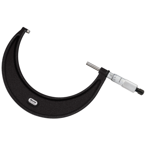

Starrett 436.1 Outside Mechanical Micrometers are the most popular precision micrometers used by skilled workmen worldwide. They are accurate, rugged, and easy to use. V436.1MXRL-175 features a 150-175mm range, 0.001mm graduations, with flat, micro-lapped carbide measuring faces. The locknut is knurled ring type with a ratchet thimble. Produced with a satin chrome finish on the sleeve and thimble for easy readability and a black wrinkle frame finish. Standard Letter of Certification (SLC) is available as an optional add-on. The 436.1 blends quality construction with smooth, repeatable performance—making it the go to mic for shop floors, inspection rooms, and manufacturing environments where accuracy cannot be compromised.
