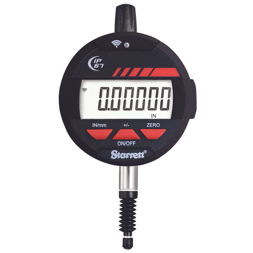

Intuitive design and layout - Easy to learn and use
Positive, tactile-feel button activation
Rechargeable battery port
IP67 protection against dirt, dust water and coolant to withstand hostile shop environments
Data collection capable via wireless
CE compliant
Lug on Center and Flat Back
Standard Feature Set
Feature 09:
Absolute Sensor Feature
Feature 10:
270 Degree Bezel Rotation
Feature 11:
1/2" / 12mm Display Character Height
Feature 12:
Dust Cap Included
Feature 13:
Charging Cable Included
Dimension Type:
Inch and Metric
