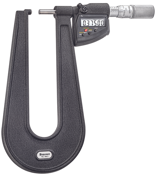

The Starrett W764.1 Series Wireless Sheet Metal Micrometer is a full-featured precision measuring tool built with customary Starrett quality and workmanship. The 764 series includes a large, easy-to-read, high-contrast LCD digital readout for clear readings. Equipped with rounded anvils that gives a point contact for more accurate gaging. Includes 6" Throat Depth with Standard Inch Graduations on Shell and Thimble. Its no-glare satin chrome finish minimizes annoying surface glare under bright lights indoors or filters out UV light. This model features 0.00005"in & 0.001mm resolution and 0-1"in & 0-25mm measuring range. Starrett electronic micrometers guarantee a precise measurement at every position each and every time. 6" Throat Depth, 0-1" (0-25mm) Range, Round Anvil, with Output, Carbide Faces.
Free Mobile Application
To use the wireless feature, download the free Datasure Mobile application from App Store (iOS) or Play Store (Android devices). Your wireless Starrett tool will communicate to your mobile device from a distance of up to 30 feet. Send the data with the click of a button or your Starrett wireless gage. It is automatically collected on your device, and can be emailed. air-dropped or texted. The datasure app also provides lots of features and functions such as digital read out (DRO), formulas, unit conversions (SAE/mm), ability to name tools (connect 5 to 8 tools depending your on device capability), name parts being measured, set min/max levels, use device as a remote display, and much more. Download the brochure or give us a call for more details!
