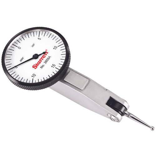

The Starrett 3809 precise, high quality test indicator offers a full complement of standard features. Indicator includes two contact points, two dovetail clamps, swivel post holder, tool post holder, contact wrench and case.

- Three dovetail positioning mounts work with most existing test indicator accessories
- Precision gear-driven design with smooth, jeweled movement
- Contact point reverses automatically, always maintaining clockwise hand rotation
- Contacts are frictionally adjustable and replaceable
- Meets or exceeds ANSI/ASME accuracy specifications
- High contrast, easy-to-read dials with a white background on inch reading and a yellow background on millimeter reading indicators
- Narrow body for in reach ability
- Satin chrome finish for durability
- Attachments:
- .078" & .156" contact points, 3/8" & 5/32" dovetail clamps, .156" swivel post holder, tool post holder, contact wrench & case
