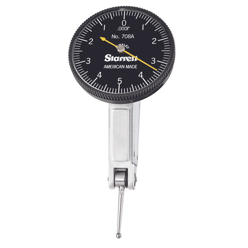

The Starrett 709 Dial Test Indicator with Dovetail Mount offers an easy to read angled head and the flexibility of three dovetail mounts. White Dial, .030" Range, .0005" Grad, without Attachments.

- These precision test indicators offer an easy to read angled head and the flexibility of three dovetail mounts
- Three dovetail positioning mounts work with existing test indicator accessories
- Precision gear-driven design with smooth, jeweled movement
- Contact point reverses automatically, always maintaining clockwise hand rotation
- Contacts are frictionally adjustable and replaceable
- Revolution count hand for easy reading
- Meet or exceed ISO accuracy specification
- Inch reading indicators are available with easy-to-read, shaded white, red, or black dials - millimeter reading indicators with yellow dials
- Feature 09:
- Angled head for better reading position
- Feature 10:
- Narrow body for inreach ability
- Feature 11:
- Satin chrome finish for durability
- Feature 12:
- Large 1-3/8" (35mm) dial diameter
- Feature 13:
- Include long carbide contacts 13/16" (20mm)
