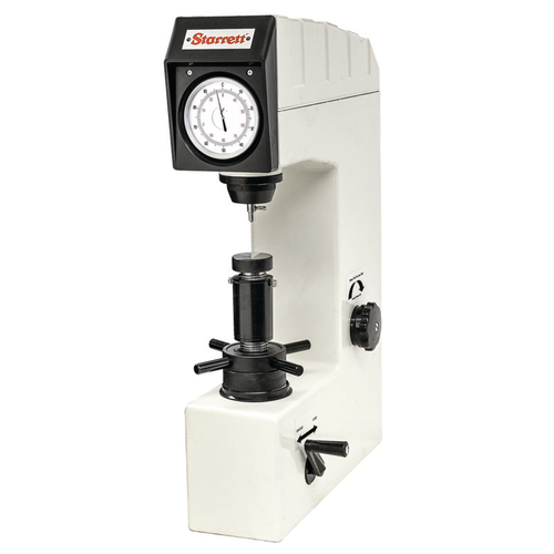

The 3814 Hardness Tester provides reliable Rockwell Hardness values on all types of metal and alloys, hard or soft, and in many shapes. This reliable bench hardness tester has a high quality casting, is ergonomically designed for easy operation and is engineered to ensure accurate results. It is an ideal basic hardness solution, economically priced to suit a variety of lab, workshop, toolroom and inspection department applications. The tester is furnished with a diamond indentor, a 1/16" (1.6mm) ball indentor, three certified test blocks, four test tables - 5.87" (149mm) and 2.5" (63.5mm) flat anvils, 5/8" (15.9mm) spot anvil and a standard vee anvil - and an accessory case.

- A: 60Kgf, B: 100Kgf, C: 150Kgf
- Maximum Test Height
- 6.69" (169.9mm)
- Minor Load
- 10Kgf
- Results Display
- Dial
- Test Force Application
- Dead weight applies test force
- Test Force Control
- Hydraulic Dashpot System
- Throat Depth
- 6.6" (168mm)
- Unit Height/Width/Depth
- 30 x 8.5 x 20" (762 x 216 x 508mm)
- Unit Weight
- 261lb (118kg)
- Hardness Scale
- Rockwell
- Weight
- 261
