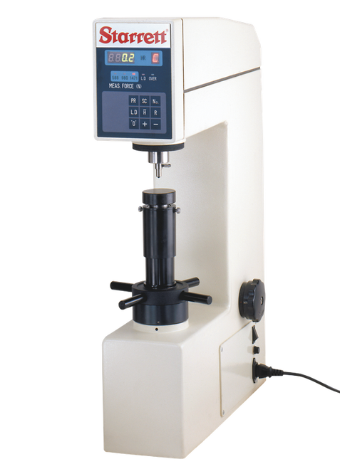

The 3825 Brinell hardness tester incorporates the latest load cell and closed loop technology. The test load is applied via a closed-loop control unit with a load cell, a DC motor and an electronic measurement and control unit. The result is highly accurate Brinell hardness measurements at all test loads up to 0.5%. The common load overshoot or undershoot as known from traditional dead weight, or open-loop, systems is eliminated. The absence of mechanical weights not only eliminates friction problems but also makes the equipment less sensitive to misalignments caused by vibrations. The whole weight of the Brinell Hardness tester is 50% less than the traditional dead weights type tester. Test load selection by keyboard and LCD screen. The Brinell hardness Tester features a fully automatic test cycle, load application, holding, unloading, is performed fully automatically. This greatly improves reproducibility of test results since operator influence is eliminated. The directions for 0.102F/D2 ratios selecting according to the materials and hardness range can be showing on the screen. Equipped with a 20X optical microscope to measure the diameter of Brinell indention. Brinell Hardness Calculator (BHC) make the Brinell hardness value calculation easier and convenient.
3825 Digital Motorized Brinell Hardness Tester

- 3000kgf (29400N), 1500Kgf (14700N), 1000Kgf (9800N), 750Kgf (7355N), 500Kgf (4900N), 250Kgf
- Maximum Test Height
- 9" (228mm)
- Results Display
- Digital
- Throat Depth
- 5.5" (140mm)
- Unit Height/Width/Depth
- 21 ×10.5 ×29.5" (535mm x 267mm x 750mm)
- Unit Weight
- 242lbs Net / 275lbs Shipping
- Hardness Scale
- Brinell

- Electronic
- Load Cell driven system provides precise control of test force application
- Direct digital reading
- Engineered to obtain highly sensitive and accurate readings
- Perfect for laboratories, workshops, tool rooms, inspection labs, etc.
- Measuring Range: 8-650HBW
- Hardness Scale:
- Brinell
- Major Load:
- Maximum Test Height:
- 9" (228mm)
