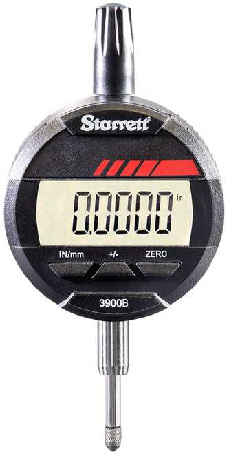

The 3900B Series Electronic Indicators with output have simple, powerful, easy-to-use functions, all at an attractive price. Converts inches / metric with the press of a button. Ships with flat back installed, and includes a lug-on-center back as an accessory. The 3900B-1 features a 1"/25.4mm Range, .0005"/0.01mm Resolution,and 3/8" Stem Diameter with 4-48 Screw Thread with Output.

- 1"
- Range (in)
- Range (mm)
- 25mm
- Resolution (in)
- .0005"
- Resolution (mm)
- 0.01mm
- Accuracy (in)
- +/- .001"
- Accuracy (mm)
- +/- 0.03mm
- Feature Set
- Standard
- Stem Diameter (in)
- .375"
- Output
- Cabled Only

- Electronic
- SPC Output
- English-Metric conversion
- Large, easy-to-read LCD
- Lug-on-center back + additional flat back
- 3/8" Stem Diameter
- 4-48 Screw Thread
- Dust Cap
- Plastic storage case with form fit foam insert
