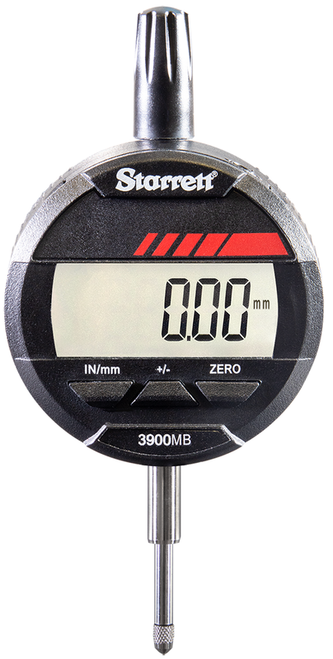

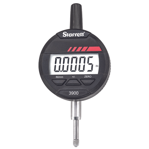

The 3900B Series Electronic Indicators with output have simple, powerful, easy-to-use functions, all at an attractive price. Converts inches / metric with the press of a button. Ships with flat back installed, and includes a lug-on-center back as an accessory. The 3900B-5 features .500"/12.7mm Range, .0005"/0.01mm Resolution, 3/8" Stem Diameter with 4-48 Screw Thread, and Output.
