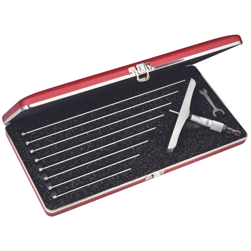

The Starrett 440, 440M, 445, 445M Series Depth Micrometer features a combination ratchet and speeder, ring-type locknut, ratchet stop and locknut. 0-225mm Range, 63.5mm Base, 9 Rods, Ratchet Stop, Lock Nut, Case.

- Mechanical
- Range (mm)
- 0-225mm
- Accuracy (mm)
- Mic head '+/-.0025mm; Rods '+/-.005mm
- Graduations (mm)
- 0.01mm
- Lock Nut Type
- Ring Type Knurled
- Base Length (mm)
- 63.5mm
- Measuring Rods (qty)
- 9
- Rod Diameter (mm)
- 3.2mm
- Thimble Type
- Ratchet
- Case Type
- Padded Case
- Rod Diameter (mm)
- 3.2mm

- Mechanical
- The depths of holes, slots, shoulders and projections can be measured with these fine tools
- 2-1/2" (63.5mm) base and 1/8" (3.2mm) diameter measuring rods
- Combination ratchet and speeder for uniform pressure and quicker adjustment
