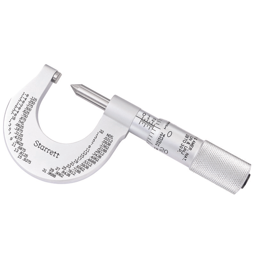

The Starrett 575 micrometers have a pointed spindle and a double V-anvil, both shaped to contact the screw thread. The micrometer reading therefore gives the pitch diameter. 0-1" Range, .001" Grad, 7-9 TPI.

- Design allows 50% to 75% contact with the thread to be measured, insuring contact with the pitch diameter at all times
- Feature 10:
- For measuring American Unified National series and Unified J series screw threads
