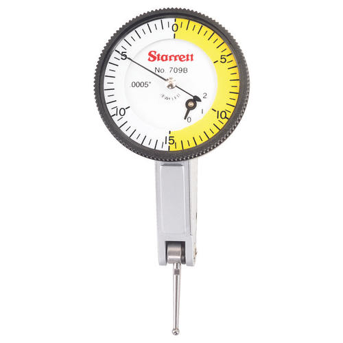

These precision test indicators offer an easy to read angled head and the flexibility of three dovetail mounts
Three dovetail positioning mounts work with existing test indicator accessories
Precision gear-driven design with smooth, jeweled movement
Contact point reverses automatically, always maintaining clockwise hand rotation
Contacts are frictionally adjustable and replaceable
Revolution count hand for easy reading
Meet or exceed ISO accuracy specification
Inch reading indicators are available with easy-to-read, shaded white, red, or black dials - millimeter reading indicators with yellow dials
Feature 09:
Angled head for better reading position
Feature 10:
Narrow body for inreach ability
Feature 11:
Satin chrome finish for durability
Feature 12:
Large 1-3/8" (35mm) dial diameter
Feature 13:
Include long carbide contacts 13/16" (20mm)
