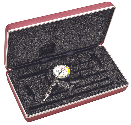

The Starrett 711 Last Word Dial Test Indicator is among the most versatile available. Their small size and variety of attachments will handle all jobs with ease and accuracy. A very useful feature is the shaded dial - when used with a mirror, such as in a jig bore application, the operator will always know what the correct reading is. Indicator with Body Clamp.

- Indicators are furnished with one interchangeable steel contact point, PT07087
- The venerable Last Word Dial Test Indicator is among the most versatile available
- Their small size and variety of attachments will handle all jobs with ease and accuracy
- A very useful feature is the shaded dial - when used with a mirror, in a jig bore application, the operator will always know the correct reading
- Ideal for precise measurements in all machining, layout, and inspection work
- Variety of attachments available to suit the application
- Easy reading dials, half yellow for clarity
- Hard chrome-plated ratchet contact point

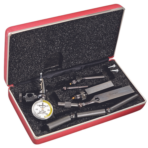

- 711 Last Word Test Indicators with Cases
