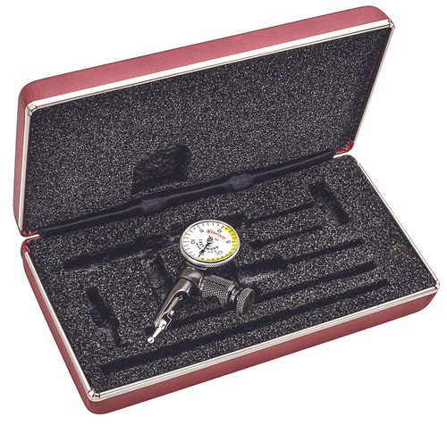

The Starrett 711 Last Word Dial Test Indicator is among the most versatile available. Their small size and variety of attachments will handle all jobs with ease and accuracy. A very useful feature is the shaded dial - when used with a mirror, such as in a jig bore application, the operator will always know what the correct reading is. Indicator Complete with All Attachments.

- 3 contact points, body clamp, universal friction holder with shank, universal shank complete with long and short arm, double-jointed attachment, height gage attachment, surface gage attachment, coupling with 3/16" (4.8mm) hole.

- Indicators having C in the catalog number are furnished with 3 interchangeable steel contact points
- The venerable Last Word Dial Test Indicator is among the most versatile available
- Their small size and variety of attachments will handle all jobs with ease and accuracy
- A very useful feature is the shaded dial - when used with a mirror, in a jig bore application, the operator will always know the correct reading
- Ideal for precise measurements in all machining, layout, and inspection work
- Variety of attachments available to suit the application
- Easy reading dials, half yellow for clarity
- Hard chrome-plated ratchet contact point
- Feature 09:
- Smooth, jeweled lever action
- Feature 10:
- Swiveling tubular body
- Feature 11:
- Positive reversing switch
- Feature 12:
- Indicator Complete with All Attachments
